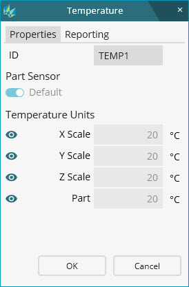

  1. Select Insert | Gage | Temperature to open the Temperature dialog box.
You can also access the Temperature dialog box from the QuickMeasure toolbar. Click the Gage drop-down arrow, and then click the Temperature button.
  1. Complete the Properties tab and Reporting tab.
Properties Tab
Use the Properties tab to set the ID, sensor numbers, and other parameters.
Properties tab - Temperature dialog box
ID box - Type the ID of the Temperature Gage command.
Part Sensor option - Usually, a machine is equipped with only one part temperature sensor. This sensor appears as Default. You cannot cancel the selection of this sensor. If your machine is equipped with multiple part sensors, they appear in this area. For example:
Part Sensor area
Select the sensor or sensors that are connected to the part being measured. Ensure that you select the correct sensor number. If you select multiple sensors, PC-DMIS uses the average of two measured values.
Temperature Units area - The X Scale, Y Scale, Z Scale, and Part boxes display the current temperatures as measured. You cannot change the values. The temperature units and the default sensor number are as selected in Edit | Preferences | Temperature Compensation Setup.
Show in Dimension/Hide in Dimension - This button shows () or hides () the temperature units in the command. You need to show at least one temperature unit or axis.
OK button - To save your settings and insert the Temperature Gage command into the Edit window, click OK.
Cancel button - To close the dialog box without applying any changes, click Cancel.

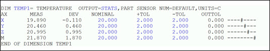

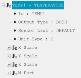

The Edit window displays the command as a dimension. It appears in Summary mode as shown below:
Summary mode
It appears in Command mode as shown below:
Command mode
The command appears according to the format statement in your measurement routine.
If the controller is equipped with only one part temperature sensor, the PART SENSOR NUM field appears in the Edit window. If your controller is equipped with multiple part sensors, and you selected a part sensor number in the Part Sensor area in the Temperature dialog box, the number appears in the Edit window.
