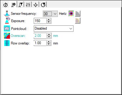

Probe Toolbox - Laser Scan Properties tab
The Laser Scan Properties tab defines how PC-DMIS acquires data from the scan, and whether or not scan lines and feature visualizations appear in the Graphic Display window.

PC-DMIS limits how the stripes appear in the Graphic Display window to
the distance of the feature nominal plus the Overscan value. The software uses the Overscan value to control the amount of clipping
and the visibility of the stripe. The graphic below gives an example of
how these stripes appear.
