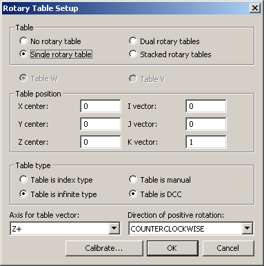

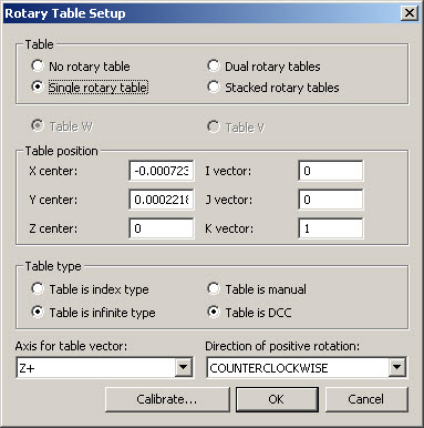

Select Edit | Preferences | Rotary Table Setup, ensure the Single rotary table is selected, and clear the offsets if you are calibrating from scratch as shown below:
Rotary Table Setup Dialog Box

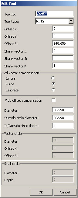

Once you define the probe, click Edit, and add a new Ring Tool. Enter the ring diameter in the Diameter and Outside Circle Diameter boxes since this will be used to create the circle features - one on the right-hand side (X>0) of the spindle and the other on the left-hand side (X<0).
Edit Tool Dialog Box for Ring Calibration

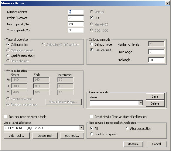

The 2d Vector Compensation is shown to be turned off and the Y Tip Compensation omitted although these options are still available if required. Click OK, and then create the calibration measurement routine. To do this, click Measure from the Probe Utilities dialog box to display the Measure Probe screen.
Measure Probe Dialog Box for Extended Lathe

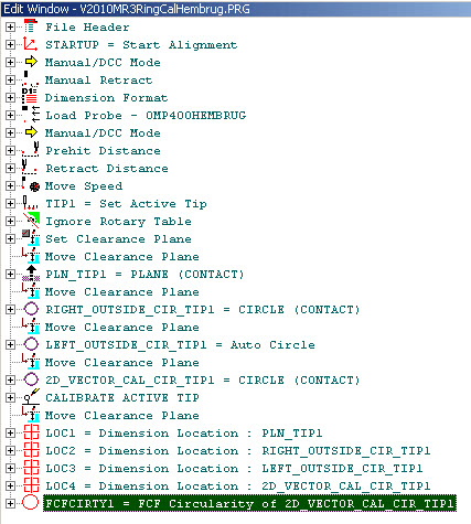

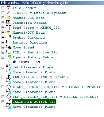

Click Measure to create the calibration measurement routine shown below:
Calibration Measurement Routine for Extended Lathe

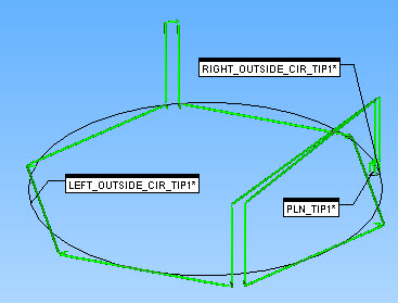

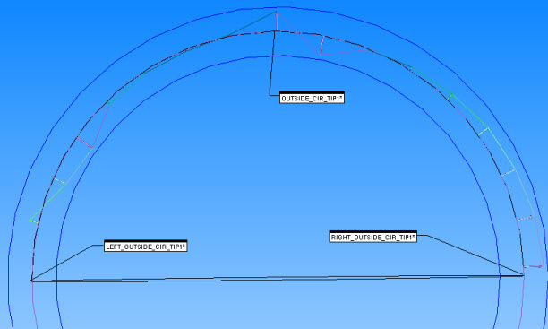

A single outside circle and a plane are needed on the artifact used for calibration. The measurement routine generated splits the circle into two semi-circles.
The right-hand circle will be measured by rotating the artifact. Hits are taken along the X axis at X>0.
The left-hand circle will be measured by rotating the artifact. Hits are taken along the X axis at X<0.
Calibration Measurement Routine Graphical View

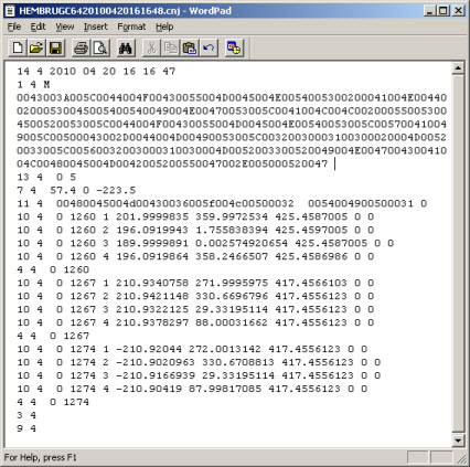

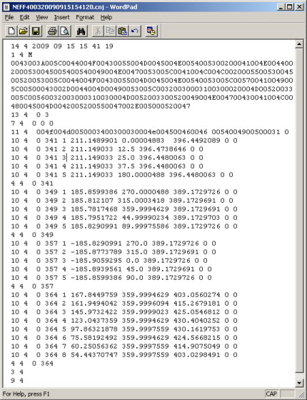

Create and run the measurement routine as normal to generate the journal file shown below:
Extended Lathe Journal File

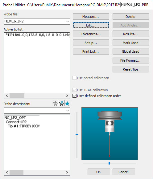

From the Probe Utilities dialog box, click on the Active Tip from the list, then click Edit to open the Edit Probe Data dialog box to view the updated values.

Select Edit | Preferences | Rotary Table Setup to view the updated Rotary Table values.
Updated Rotary Table Setup Dialog Box for Extended Lathe

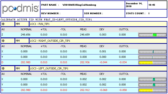

To perform the post-calibration sanity check, switch off the Ignore Rotary Table in the measurement routine, clear the Calibrate Active Tip line, and re-run the journal file (or better still, run the measurement routine on the machine) to see if a near-perfect result is achieved.
Extended Lathe Updated Report

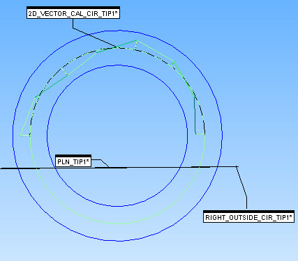

Create the calibration measurement routine as before. In this case, the 2d Vector Calibration circle has been edited to measure eight hits instead of five to match to saved journal file data.
Measurement Routine for Ring Calibration with 2d Vector Compensation

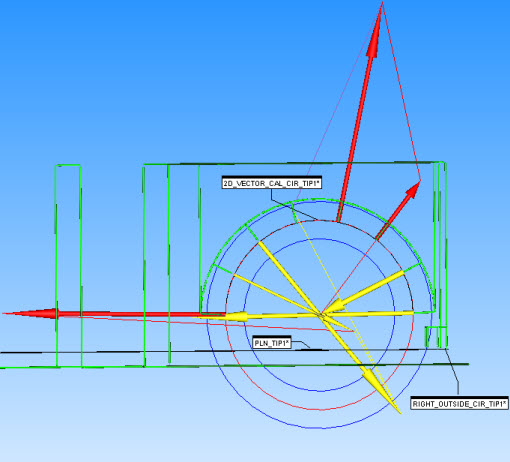

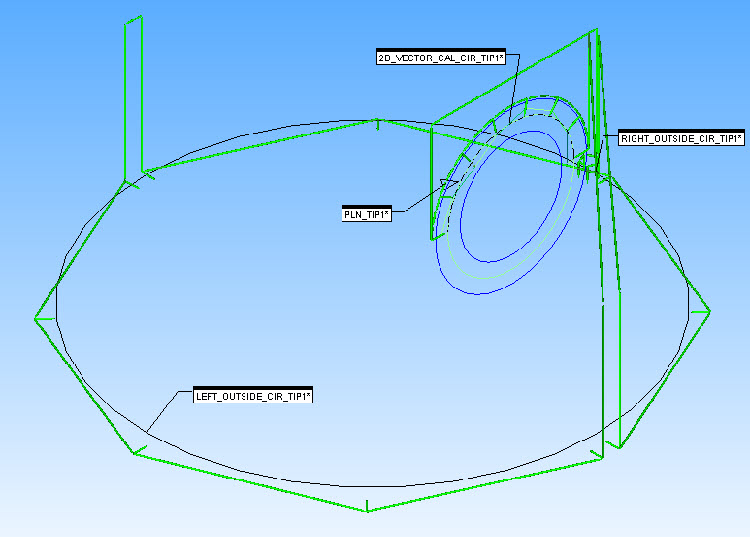

Run the measurement routine to display the following in the Graphic Display window:

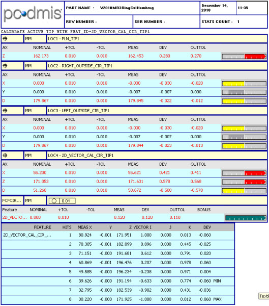

Starting again from nominals for the tip and rotary table and using the dimensioning shown above, PC-DMIS produces the following report:
Updated Calibration Report for Ring Calibration with 2d Vector Compensation

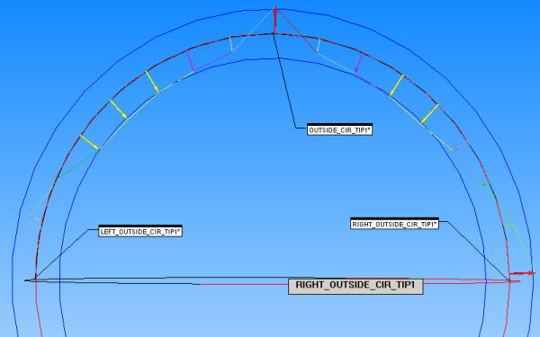

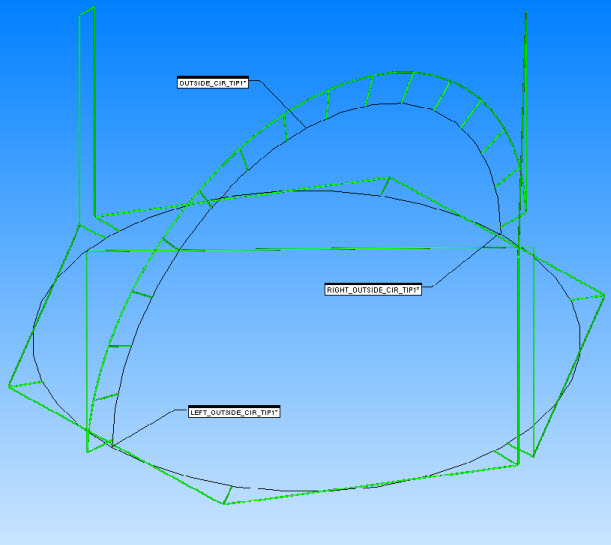

Graphically, the Out of Circularity found during calibration is shown below:
Updated Graphical View of Ring Calibration with 2d Vector Compensation

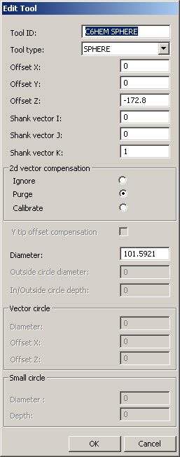

Add a Sphere Tool from the Probe Utilities dialog box by clicking Edit. Click OK when done.
Edit Tool for Adding a Sphere Tool

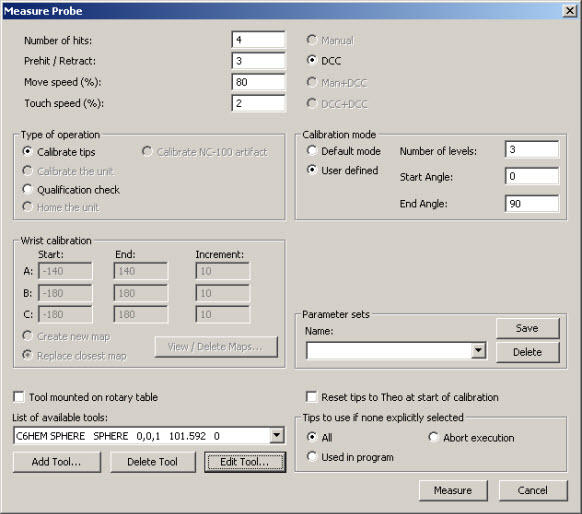

From the Probe Utilities dialog box, click Measure to display the Measure Probe dialog box.
Measure Probes Dialog Box for Sphere Calibration

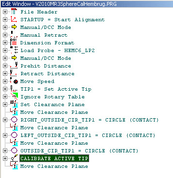

Make the necessary change, and then click Measure to create the Calibration measurement routine as shown below:
Sphere Calibration Measurement Routine

Create and run the measurement routine as normal. A journal file is created, similar to the following:
Sphere Calibration Journal File

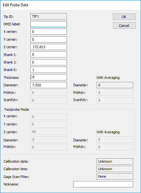

From the Probe Utilities dialog box, click on the active tip from the list, then click Edit to open the Edit Probe Data dialog box shown below to view the updated values.
Sphere Calibration Edit Probe Data Dialog Box
Sphere Calibration Rotary Table Setup Dialog Box

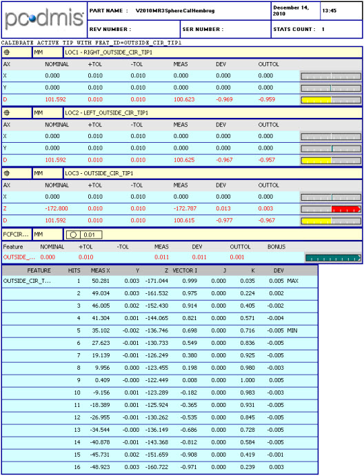

Turn the Ignore Rotary Table off, clear the CALIBRATE ACTIVE TIP and then re-run the journal file. The report is near perfect as shown below:
Updated Sphere Calibration Report

Add the Sphere Tool with 2d Vector Compensation as shown below. Click Edit from the Probe Utilities dialog box to open the Edit Tool dialog box.
Edit Tool Dialog Box for Sphere Calibration with 2d Vector Compensation
