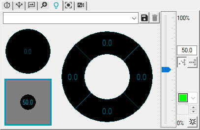

At any one time, only one of the lamps can have its settings changed. This is referred to as the "active" lamp, and is the lamp that is not drawn in a "Dimmed" state.
Illumination tab showing active lamp (bottom light)
In the above example, the bottom light (lower left) is active, and the top light and ring light are "OFF".
