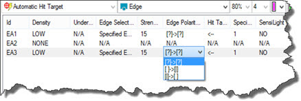

Once an active target has been executed, parameters such as Target Width, Edge Type, Edge Polarity, Focus, and Filter can be edited. If changes are made to any of these parameters, a re-execution of the last active target is triggered.

Click in each of the Edge Polarity fields to change the settings as necessary.
