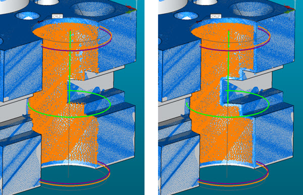

You can enable the CAD offset option for all 3D auto features (Plane, Cone, Cylinder, and Sphere). The CAD offset option provides a way for PC-DMIS to "shrink away" from the selected CAD face and eliminate points which are within the offset distance to the edges of the feature.
For Plane auto features, when you select this check box, PC-DMIS creates a yellow offset boundary around each feature in the CAD model on the surface. For a Cone, Cylinder or Sphere auto feature, PC-DMIS does not display this yellow offset boundary outline.
Example of a Plane auto feature with CAD-based clipping enabled
Example of a Cylinder auto feature with no CAD offset (left) and with 2mm CAD offset (right)
You must select a CAD face when using the CAD offset option.
PC-DMIS clips the laser data that falls inside of an offset boundary for all of the features in the CAD model on a surface. PC-DMIS uses the data outside of the offset boundary to solve the plane.
