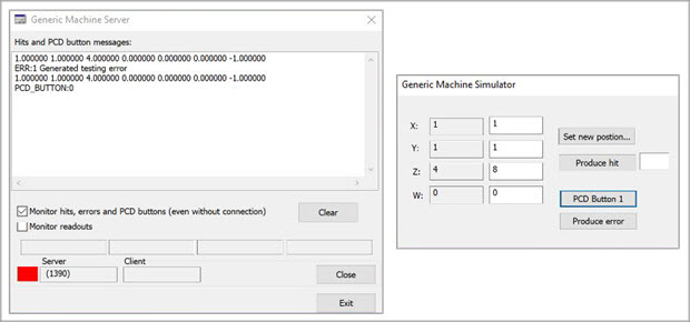

When you allow monitoring in GMServer, the window shows the PCD button click information: PCD_BUTTON:0 for PCDMIS_BUTTON_DONE.
Example of PCD button click with simulator
