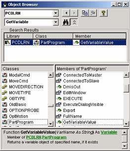

The Object Browser, available in standard Visual Basic Editors, is essential to getting the proper help when writing automation scripts. It contains all the different objects for any library you have chosen to use in your automation project.
Example Object Browser

  6. Access the Object Browser (press F2 within the VB Editor). In the list at the top it should say <All Libraries>. From the list, select the PCDLRN library.
You can now browse through all the objects and view their properties, methods, and events. Most of the objects have properties and methods in the PC-DMIS object library. Only a few objects have events.
Additionally, when writing code, your Visual Basic Editor will now contain the visual syntax aids for the various PC-DMIS objects and commands.
