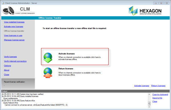

  1. Start the appropriate CLM Administration application described above, and click the Offline license transfer option.
  1. Click Activate licenses on the next screen.
