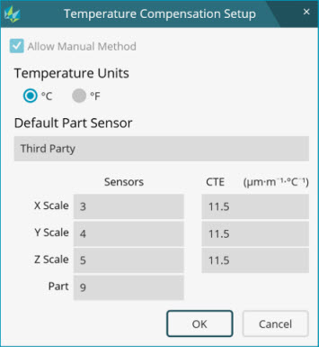

Non-Hexagon Systems
For a machine that is connected to a non-Hexagon controller, the following options appear in the Temperature Compensation Setup dialog box:
Non-Hexagon system
Allow Manual Method check box - It may or may not be possible for PC-DMIS to get the temperature of axes and parts from the controller. When PC-DMIS cannot automatically read the temperatures, the only temperature compensation option is the manual entry of temperatures. This check box is selected by default. You must enter the CTE values for the scale of each axis to compensate for temperature of scales.
You need to enter the temperature of the X scale, Y scale, Z scale, and part at the time of measurement routine execution.
In some cases, it may be possible for PC-DMIS to read the temperature from the controller. In these cases, enter the sensor numbers and CTE values for the scale of each axis and part.
Default Part Sensor list - This list, and the Part Sensor area in the Temperature Compensation dialog box, display Third Party.
OK button - To save your settings, click OK.
