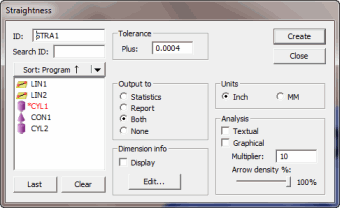

Dimension Straightness dialog box
A minimum of three hits are necessary to determine the straightness of a line.
The Insert | Dimension | Straightness option calculates the straightness of a line. This dimension type is considered one sided, meaning a single positive value tolerance is applied.
