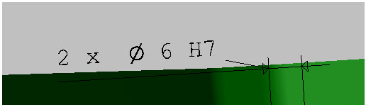

ISO tolerances have an alphanumeric label instead of normal plus and minus tolerance values. The labels appear as "H7", "h7", or "G9", for example, as shown below.
Example of ISO tolerances in a PC-DMIS graphic

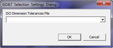

For PC-DMIS to use a tolerance CSV file, you need to select that CSV file from the GD&T Selection Settings Dialog dialog box. Use the ISO Dimensions Tolerance File combination box from the GD&T Selection Settings Dialog dialog box to choose the CSV file that you wish to use as shown below.
To open this dialog box, select Edit | Preferences | CAD GD&T Selection in PC-DMIS.
