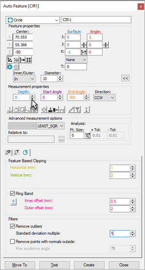

For 2D Laser Auto features (Circle, Polygon, Round Slot and Square Slot), the Remove outliers filter is only available if the Depth value in the Measurement properties area of the Auto Feature dialog box is set to 0 (zero).
Example setting Depth to 0 (zero) to enable Remove outliers filter option
