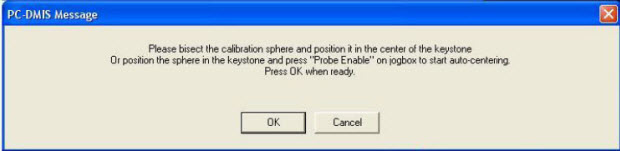

PC-DMIS Message

You can manually bisecting the sphere and bring it in the center of the Keystone and then press OK to start the laser calibration.
Display a portion of the calibration sphere in the Laser View and then press the Probe Enable button to automatically center the sphere. When completed, press the OK button to complete the laser calibration.
The PC-DMIS Message dialog box appears as soon as PC-DMIS determines that the calibration sphere has been moved.
Follow the instructions as described in the message box.
