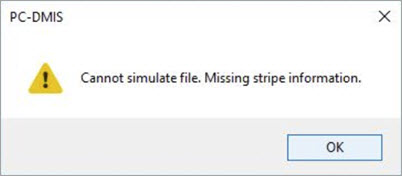

The pointcloud file must contain stripe information. If the file you select does not contain stripe information, as soon as you click the Simulate button, PC-DMIS displays an error message that says it cannot simulate the file because it's missing stripe information. It then aborts the import process:
