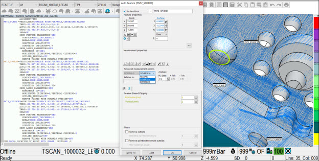

Spherical Surface Point Calculation Method
This method calculates the laser surface point by fitting a local sphere on the scan points within the circular area defined by the horizontal and vertical clipping parameters.
The following are examples with details:
Sherical surface point example
Spherical surface point example
Spherical surface point example - details
