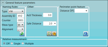

PP feature:
General feature parameters group for PP feature

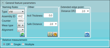

EEP feature:
General feature parameters group for EEP feature

The following table describes the options. The options that appear depend on the feature you are creating. For descriptions of the icons that appear in this group, see "Using the Icons".
Item |
Description |
Naming Rules area |
Type list: Select the type of naming rule:
Counter box: Type the four-number feature counter. The following options appear when you select the VW type:
Other area |
Actl Thickness box: Type the thickness to be applied as an actual value to the surface or edge values of the feature. Safe Distance list: Type the distance move before and after the measurement. |
Perimeter point feature area |
Distance DP1 list |
Extended edge point area |
Distance DP2 list |
Relative measurement area |
Off option: Select this option if you do not want to use relative measurement. Single option: Select this option to measure a single feature from the XYZ list. The XYZ list appears when you select Single:
Single option Multiple option: Select this option to measure multiple features (one for each axis) from the X, Y, and Z lists. These lists appear when you select Multiple:
Multiple option |
