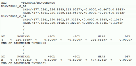

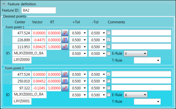

Example
The following is an example of a Feature definition group for the BA feature and the corresponding Edit window:
Example of BA feature
Example of Edit window
