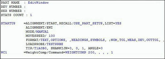

Here is an example of the Edit window for the Centered Weight mode:
Example of Edit window for Centered Weight mode
