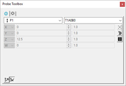

When set to True, PC-DMIS displays a pair of user interface buttons on the Position Probe tab of the Probe Toolbox. These buttons allow you to toggle between these two modes.
Probe Toolbox Position Probe tab showing buttons when ReadoutButton = True

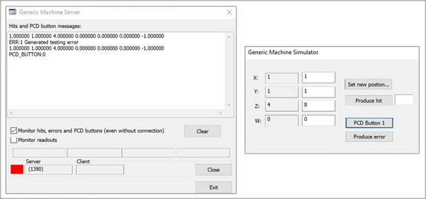

When you allow monitoring in GMServer, the window shows the PCD button click information: PCD_BUTTON:0 for PCDMIS_BUTTON_DONE.
Example of PCD button click with simulator
