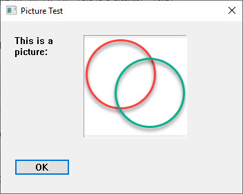

Example - Picture Statement
  1. ' This example uses the picture control to show a picture.
  2. Sub Main ()
  3.     Begin Dialog myDialog 60, 60, 175, 125, "Picture Test"
  4.         Text 10, 10, 50, 50, "This is a picture:",.Text1
  5.         Picture 60, 10, 75, 75, "d:\temp\test.bmp",0,.Picture1
  6.         OKButton 10, 100, 40, 12
  7.     End Dialog
  8.     ' Dialog returns -1 For OK
  9.     Dim Dlg1 As myDialog
  10.     button = Dialog(Dlg1)
  11.     If button = -1 Then
  12.         Exit Sub
  13.     End If
  14. End Sub
Example Picture Control
