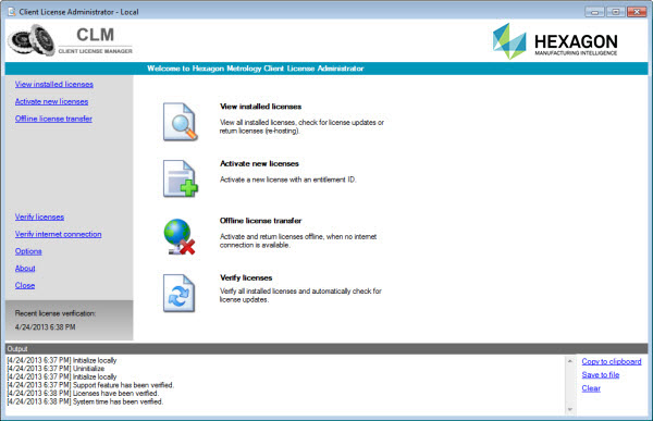

Start the CLM Licensing tool. To do this, double-click the CLM Admin desktop shortcut that was created during the installation of the Hexagon software product. The Client License Administrator dialog box appears.

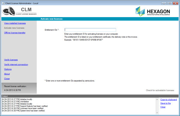

Click Activate new licenses, and type or copy your entitlement ID into the Entitlement ID box.
Client License Administrator dialog box - Activate new licenses
Click Check for activatable licenses to display the summary of the license.
Click Activate new licenses.
