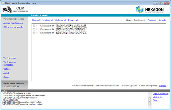

Select View installed Licenses. The list of currently-activated entitlements appears.
Select the Entitlement ID to return.

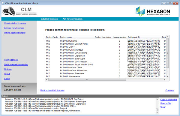

Select Return Licenses. The list of currently-selected licenses for return appears.
Select Continue to confirm the return of the selected licenses.
A connection to the Hexagon Network License Server is established, and the selected licenses are returned.
