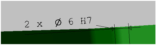

ISO tolerances have an alphanumeric label instead of normal plus and minus tolerance values. The labels appear as "H7", "h7", or "G9", for example, as shown below.
Example of ISO tolerances in a PC-DMIS graphic
The following is based on the ISO Standard 286-1, ISO system of limits and fits.
The letter ("H", "h", "g", etc.) indicates the tolerance class. It is case-sensitive: capital letters indicate holes or other internal shapes, while lower-case letters indicate stems or other external shapes.
The number indicates the grade of the tolerance.

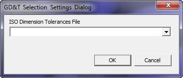

To import a tolerance CSV file:
  1. Select Edit | Preferences | CAD GD&T Selection to show the GD&T Selection Settings Dialog dialog box.
  2. From the GD&T Selection Settings Dialog dialog box, use the ISO Dimensions Tolerance File combination box to choose the CSV file:
  1. Click OK to import the CSV file.
