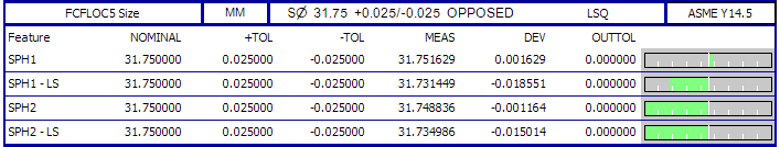

With Global and Local Sizes
When you are reporting global sizes and local sizes, the size label has extra rows, with LS added as a suffix for the worst local sizes. For example, "SPH1 - LS". For ASME tolerances on cylinders, the header bar also says whether the local size interpretation is OPPOSED or CIRCULAR. When reporting global sizes and local sizes, the report looks like this:

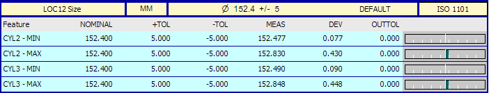

Without Global Size
When ISO 17450-3 applies, there is no global size reported. Instead, MIN and MAX are added as a suffix for the worst local sizes in both directions. The report looks like this:
