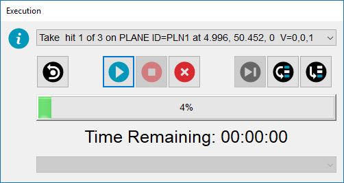

Read the instructions in the Execution dialog box. Follow the requests to take the specified hits. Make sure the ruby tip, and not the probe stem, contacts the part.
PC-DMIS detects each hit and automatically displays the message to take the next hit.
Instructions in Execution dialog box
PC-DMIS requests that you manually take these hits with your probe in the approximate location indicated in the Graphic Display window.
Take three hits on the surface to create a plane. Press End.
Take two hits on the edge to create a line. Press End.
Take four hits inside the circle. Press End.
