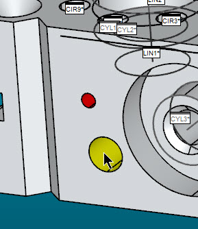

Front Face - Add an Inner Cylinder (CYL4)
This process adds the inner cylinder features on the front face into the measurement routine.
On the front face, locate the inner cylinder that is directly beneath and perpendicular to the central bore on the top face.
Hold the Shift key and hover the pointer over the inside surface of the cylinder.
Once the pointer highlights the cylinder in yellow, click the cylinder to create the feature. PC-DMIS inserts CYL4 into the Edit window.
From the measurement strategy widget, click
Apply (
to accept the feature.
