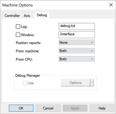

From the Machine Options dialog box (Edit | Preferences | Machine Interface Setup), select the Debug tab:
Machine Options dialog box - Debug tab when connected to non-Vision machines
Be sure to modify only the Debug tab. The other tabs on the Machine Options dialog box are used by service personnel to set up your machine.
Select the Log check box.
Type a name for the debug file in the box next to the Log check box. The default file name is debug.txt. You can also precede the file name with a full path to specify the drive and directory where PC-DMIS should send the debug file.
Click Apply and then OK to close the dialog box.

You can control the type of debug information that PC-DMIS logs and where it is sent.
Window check box: To display debug information in a window for review, select this check box and enter a name for the window in the box.
Position reports list: To log position reports from PC-DMIS, select None, Both, Log, or Window.
From machine list: To log debug information that your machine sends to your computer, select None, Both, Log, or Window. Some machine interfaces do not support this option.
From CPU list: To log debug information that your computer sends to your machine, select None, Both, Log, or Window. Some machine interfaces do not support this option.
