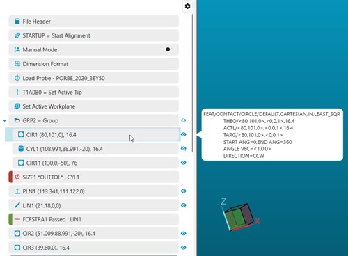

The Peek window displays a command's information when you hover over the command in the Edit window. This feature enables you to quickly identify a command's properties and become accustomed to the command's language.
The Peek window automatically updates with the properties of the command that you point to. You do not need to click on the command to update the information in the Peek window.
Hits do not appear for features in the Peek window. For a group, only the first line of the commands in that particular group appears in the Peek window.

To use the Peek window, position your mouse pointer over a command. The Peek window aligns to the center of the command.
If you move the mouse pointer, the Peek window becomes transparent with no text in it. The transparent Peek window enables you to see the application through it. The transparent window follows the mouse up and down the commands in the Edit window until you stop and hover over a command. At this point, the Peek window becomes active again and displays the command's information.

Example of an active Peek window
