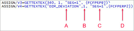

This function returns the current text from the specified data field: GETTEXTEX(<String or Integer>,<Integer>,<String>,<Pointer>)
This function has four fields.
First Field—Data Field Number or Description
The first field can be either a string description of the data field or the data field number, indicated in item (A) in the image below.
If you use the Type String Identifier instead of the Numeric Identifier (Item (A) in the image below), PC-DMIS will automatically convert it to the correct numeric value.
For example, if you pass in the string identifier "DIM_DEVIATION", internally, PC-DMIS will convert it to the numeric value 340. When you then hover over the command in the Edit window, the pop-up command shows the text string as well as the actual numeric identifier value. In this example then, if you hover the cursor over the Edit window command, the command pop-up will show (DIM_DEVIATION - 340), 1, SEG=1.
You can also just pass in the numeric value if known.
To obtain these values:
Place PC-DMIS in Command mode and then right-click anywhere in the Edit window. A shortcut menu appears.
From the shortcut menu, select Change Pop-up Display and then Data Type Information.
Position the mouse over a data field in the Edit window. The type description, type number, and type index for that data item display. Hover over an Extended D_Type to show the content string after the colon.
The type description may be different for different languages. If your measurement routine is executed on a version of PC-DMIS running in a different language, use the type number instead.
Sample Data Type Information Showing (A) Type String or Numeric Identifier, (B) Type Index, (C) Content String, and (D) Command Pointer
Second Field - Type Index
The second field is the type index, indicated as B in the above image. This field is usually zero unless you have more instances of the same type of field in the same command, such as multiple DIRECTORY fields shown in the above image. You can obtain the correct value for this field in the same manner as described for the first field.
Third Field—Content String
The third field is the content string of the extended D_TYPE, indicated as C in the image above.
Fourth Field—Command Pointer
The fourth field is a command pointer, indicated as D in the image above. It points to the command that the expression extracts data from. You can use either the command pointer notation (i.e., {FCFPERP2}) or the GETCOMMAND expression as shown in this example:
ASSIGN/V1=GETTEXTEX("DIM_DEVIATION",1,"SEG=1",{FCFPERP2}) - This command assigns V1 the current value of the deviation from feature 1, segment 1, dimension FCFPERP2.
See the "Pointer Functions" for information on the GETCOMMAND expression used for setting a pointer to a command.
The GETTEXTEX function adds support for the Extended DTypes which contain a CONTENT string. Currently, only the PC-DMIS Geometric Tolerance commands use Extended DTypes.
