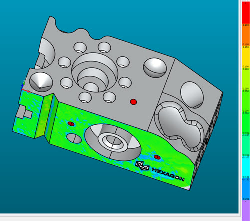

Example of the Surface Colormap applied to the first-selected CAD surfaces
Click Create to add the Surface Colormap in the Edit window.
Create a second Surface Colormap in the same manner for the next Surface Profile.
Example of the second Surface Colormap applied to the selected CAD surfaces

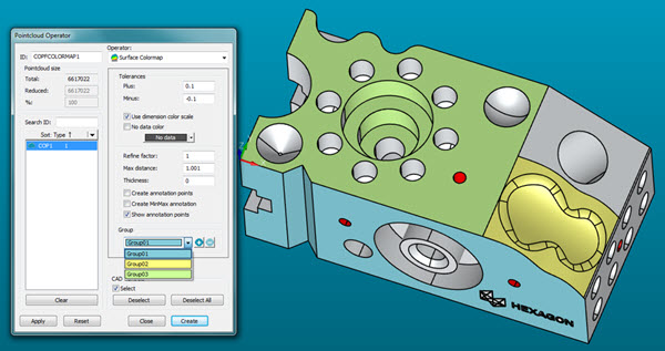

You can create groups of selected CAD surfaces within a single colormap. Each group can have different tolerances and Surface Colormap parameters (Refine factor, Max distance, and Thickness). If the Surface Colormap has two or more groups, the software displays the color scale with percentages.
Examples:
Grouped CAD surfaces (left): (A) - Group01 TOL +/-0.1mm (B) - Group02 TOL +/-0.2mm (C) - Group03 TOL +/-
Surface Colormap applied to grouped CAD surfaces (right): The colormap image on the right represents the deviations in each group using the percentage of tolerances.

Enter the tolerance values and colormap parameters (Refine factor, Max distance, and other parameters).
From the Pointcloud Operator dialog box, select the Select check box in the CAD Controls area.
Click each of the CAD surfaces to be grouped. The surfaces highlight with the group color as you click them. Click the Deselect button to remove the last highlighted surface from the group.
To group the selected (highlighted) surfaces, click the Add a new data group (+) button located to the right of the Group list.
This group remains the active group until a new group is created. Any changes made to tolerances or COLORMAP parameters are applied to the active group. Also, if you select additional surfaces, they are added to the active group.
To identify which surface belongs to which group, the selected CAD surfaces are highlighted with the group color. To identify which group a grouped surface belongs to, press and hold the Shift key and then left-click the surface. The Group list updates to show the group to which it's assigned.
If you click a CAD surface that is not in the active group, it is removed from the group it is currently assigned to, and it is added to the active group.
To create another group, click the Add a new data group (+) button again, click the surfaces on the CAD, and update the tolerances and any COLORMAP parameters as necessary. Repeat to create more groups.
Example of grouped CAD surfaces
To make changes to a group, select it from the Group list and make the necessary changes.
To delete a group, select it from the Group list and click the Remove the current data group (-) button.
When a COLORMAP contains two or more groups with different tolerances, the color scale is automatically set to show the deviations with percentages.

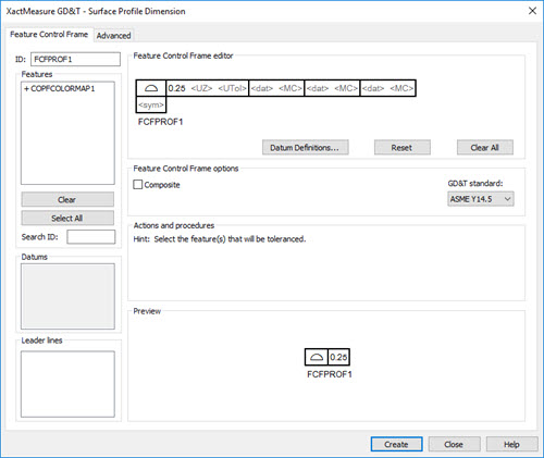

Dimensioning Surface Profile using Pointcloud Colormap with Groups
You can use Pointcloud COLORMAP Groups to dimension Surface Profiles.
Create the Pointcloud COLORMAP Groups as described in Method 2.
For legacy dimensions, do this:
Click the Profile Surface Dimension option from the Dimension toolbar (View | Toolbars | Dimension). The software displays the Surface Profile dialog box for legacy dimensions:
Surface Profile legacy dialog box for Pointcloud Colormap with Groups
For XactMeasure dimensions, do this:
Ensure that the Use Legacy Dimensions option (Insert | Dimension | Use Legacy Dimensions) is not marked.
Click the Profile Surface Dimension option from the Dimension toolbar. The software displays the XactMeasure GD&T - Surface Profile Dimension dialog box:
XactMeasure GD&T - Surface Profile Dimension dialog box for Pointcloud Colormap with Groups
Click the + sign to the left of the COPFCOLORMAP in the Features list to show any COLORMAP groups.
Select the desired COLORMAP groups and features to dimension from the Features list. If you select a datum feature, it must be a plane.
Set the other options as needed.
