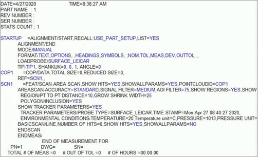

Area Scan example
Example of the Edit window showing the Area Scan command with Region settings
PC-DMIS displays the scan's path points and their XYZ coordinate locations in the Scan Points area of the Area Scan dialog box.
