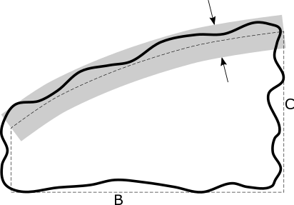

With the above specification, the actual value looks like this:
Since there are no modifiers, the tolerance zone is centered on the nominal surface, which is nominally oriented and located to each actual datum. The solid line indicates the actual surface, the dashed lines represent the nominal surfaces (including the actual datums) and the gray shaded area represents the minimum-size tolerance zone centered on the nominal surface containing the actual surface.

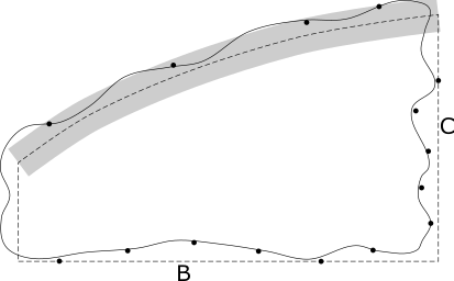

The measured value (with DEFAULT datum math) looks like this:
The measured tolerance zone center remains the nominal surface, which is nominally oriented and located to each measured datum. In this case, the measured points were not measured densely enough, and so the measured value is smaller than the actual value.

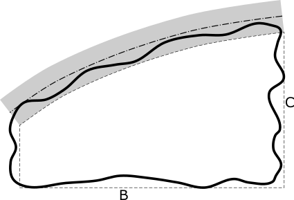

With the above specification, the specified tolerance zone looks like this:
Because this is the specified tolerance zone, the tolerance zone is not minimized, and so it does not represent the actual value. The center of the tolerance zone is offset from the nominal surface and is shown in the dashed-dotted line.

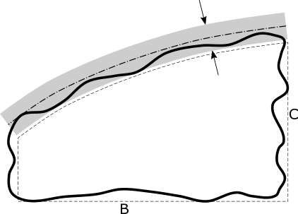

The actual value looks like this:
The center of the tolerance zone stays the same (offset 0.04 from nominal in this case), but the zone is minimized until it just contains the actual surface.

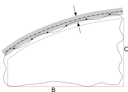

The center of the tolerance zone stays the same (offset 0.04 from nominal in this case) but the zone is minimized around that center until it just contains the measured surface points. In this case, the measured points were not measured densely enough, and so the measured value is smaller than the actual value.
You may find it helpful to remember that the measured value is equivalent to twice the absolute value of the worst deviation, measured from the center of the tolerance zone.

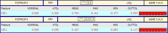

Here is an example report for a profile of a line tolerance of a circle.

Here is an example report for a profile of a line per unit tolerance. The upper label is for the overall profile of a line, and the lower label is for the per unit profile of a line.
