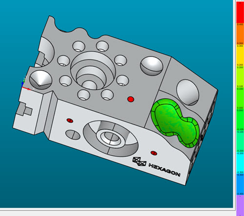

Example of the Surface Colormap applied to the first-selected CAD surfaces

  2. Create a second Surface Colormap in the same manner for the next Surface Profile.
Example of the second Surface Colormap applied to the selected CAD surfaces

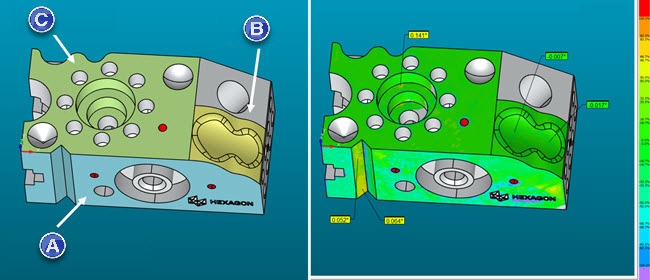

In this example, the left image shows three different grouped CAD surfaces. The image on the right shows surface color maps applied to each group, using the percentage of tolerances:
(A) - Group01 TOL +/-0.1mm
(B) - Group02 TOL +/-0.2mm
(C) - Group03 TOL +/-

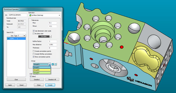

To create groups and apply different tolerances to the selected CAD surfaces within one colormap, do the following:
  1. From the Pointcloud toolbar, select the Pointcloud Surface Colormap button (). The Pointcloud Operator dialog box for the Surface Colormap appears.
  2. Enter the tolerance values and colormap parameters (Refine factor, Max distance, and other parameters).
  3. From the Pointcloud Operator dialog box, select the Select check box in the CAD Controls area.
  4. Click each of the CAD surfaces to be grouped. PC-DMIS highlights the surfaces with the group color as you click them. Click the Deselect button to remove the last highlighted surface from the group.
  5. To group the selected (highlighted) surfaces, click the Add a new data group (+) button located to the right of the Group list.
This group remains the active group until you create a new group. PC-DMIS applies any changes that you make to the tolerances or COLORMAP parameters to the active group. Also, if you select additional surfaces, PC-DMIS adds them to the active group.
To identify which surface belongs to which group, PC-DMIS highlights the selected CAD surfaces with the group color. To identify which group a grouped surface belongs to, press and hold the Shift key and then left-click the surface. The Group list updates to show the group to which it's assigned.
If you click a CAD surface that is not in the active group, PC-DMIS removes it from the group it is currently assigned to, and then adds it to the active group.
  1. To create another group, click the Add a new data group (+) button again, click the surfaces on the CAD, and update the tolerances and any COLORMAP parameters as necessary. Repeat to create more groups.
Example of grouped CAD surfaces

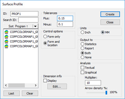

  2. For legacy dimensions, do this:
Click the Profile Surface Dimension option from the Dimension toolbar (View | Toolbars | Dimension). The software displays the Surface Profile dialog box for legacy dimensions:
Surface Profile legacy dialog box for pointcloud colormap with groups

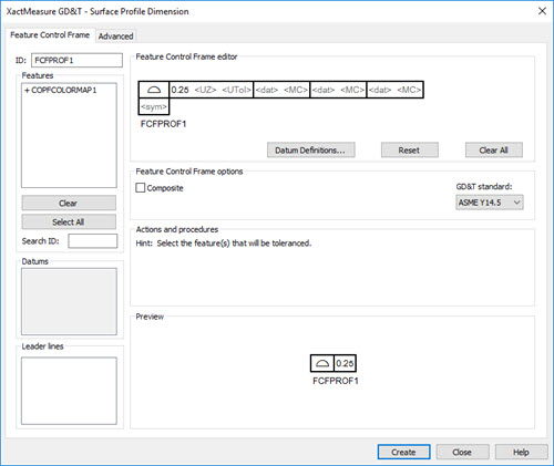

For XactMeasure dimensions, do this:
Ensure that the Use Legacy Dimensions option (Insert | Dimension | Use Legacy Dimensions) is not marked.
Click the Profile Surface Dimension option from the Dimension toolbar. The software displays the XactMeasure GD&T - Surface Profile Dimension dialog box:
XactMeasure GD&T - Surface Profile Dimension dialog box for pointcloud colormap with groups
Click the + sign to the left of the COPFCOLORMAP in the Features list to show any COLORMAP groups.
  1. Select the desired COLORMAP groups and features to dimension from the Features list. If you select a datum feature, it must be a plane.

For details on creating a legacy Surface Profile, see "To Dimension a Feature Using the Surface Profile Option" in the "Using Legacy Dimensions" chapter of the PC-DMIS Core documentation.
