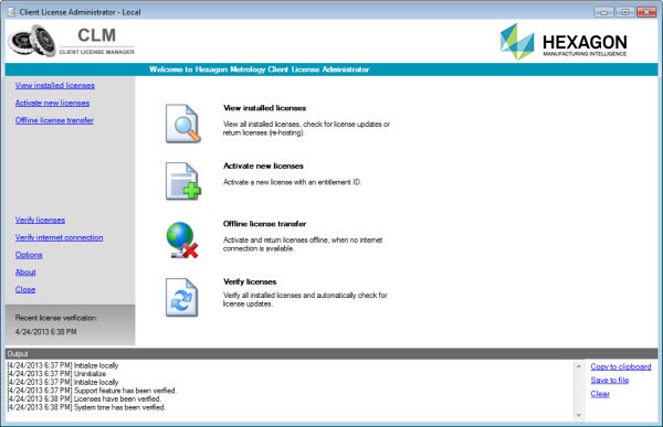

Use the "CLM Admin" desktop shortcut that was created during the installation of the Hexagon software product (PC-DMIS, DataPage+, and so on) to start the CLM Licensing tool. The Client License Administrator dialog box appears.
Click Activate new licenses and type or copy your Entitlement ID in the field.
Click Check for activatable licenses to display the summary of the installed licenses.
Click Activate new licenses.
Click View Installed Licenses to view and verify all activated licenses.
