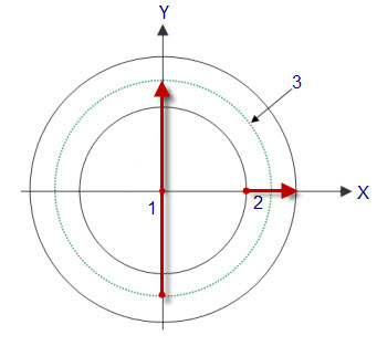

To create a measured torus, you must take a minimum of seven hits. Take the first three hits on one level of the torus's center line circle (see the diagrams below). These hits must represent the orientation of the torus so that an imaginary circle generated through these three hits would have roughly the same vector as the torus.
Top-down view of a torus. Note the major diameter (1), the minor diameter (2), and the center line circle (3).

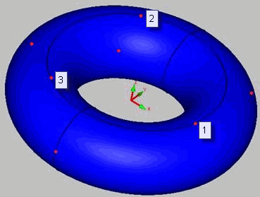

If you orient the torus and are looking down on it from a bird's eye view, with Z+ pointing up towards you, take the first three hits in a counterclockwise direction to give the torus a vector of 0,0,1. If you take the hits in a clockwise direction, the torus will have a vector of (0,0,-1).
You can probe the remaining four hits in any random location as long as they all don't lie in the same plane.
Example of a torus created from seven points, with the first three taken in a counterclockwise direction
