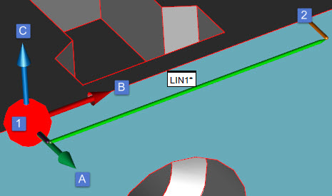

This example of a bounded Line Auto feature shows the start and end points
This example of a bounded Line Auto feature shows the start and end points (1) and (2), an edge vector of 0,-1,0 (A), a line vector of 1,0,0 (B), a surface vector of 0,0,1 (C), and a Pt. Size value of 4:

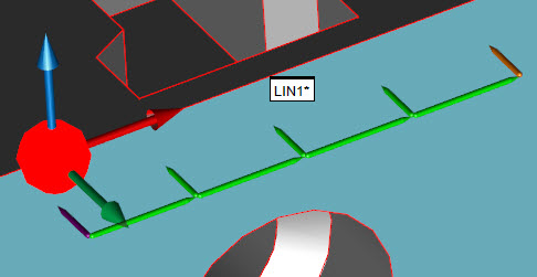

For example, you might want to change the Hits value and the Depth value:
Line Auto feature with five hits now and a depth of 3 mm
