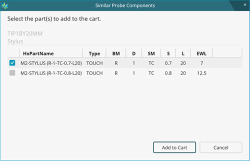

Add to Cart - To add a component to the cart, select the component and then click this icon. This icon is available only if the probe component has a Hexagon part number. For a selected stylus or extension of specified length, multiple part numbers might be available in the Hexagon catalog. The part numbers can be stylus or extensions made from different material or stem diameters. PC-DMIS checks for similar parts. If there are any available, PC-DMIS displays a menu to select the required parts.
Similar Probe Components dialog box
Mark the check box to select the required parts. To add the selected parts to the cart, click Add to Cart. To increase the quantity of the same part, click Add to Cart again. With each click, the quantity increases by one. Click Cancel to close the dialog box without adding anything to the cart.

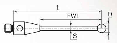

Technical
L - Length (mm)
D - Diameter (mm)
D1 - Extension End Pieces Diameter (mm)
S - Stem (mm)
SP - Span (mm)
EWL - Effective Working Length (mm)
