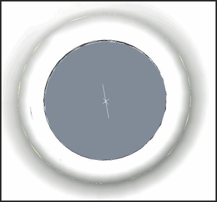

For example, in this top-down image of a circle feature seen below, you will notice a white cross and line in the center of the circle. The cross and line are CAD elements of a point and line, respectively, that are created within the CAD system and imported as part of the CAD file into PC-DMIS. You would select either the line or the cross (not the actual circle feature) to have its data input into the dialog box.
Sample wireframe point and line element at the center of a Circle feature
