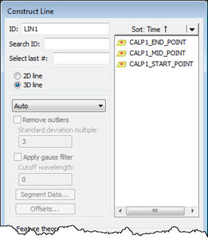

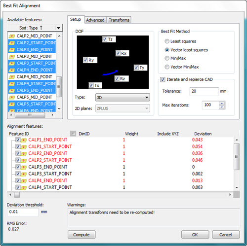

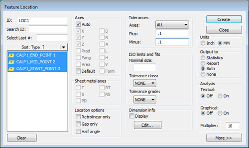

The start point, mid point, and end point automatically appear as constructed offset points in the Dimension, Construction, and Alignment dialog boxes. You can dimension the points and use them in a best fit alignment, such as when you align a cast part that has excess material.
The following examples show various uses of the Caliper start, mid, and end points when you create features and alignments:
Example of start, mid, and end point options when creating a constructed feature
Example of start, mid, and end point options when creating a feature location dimension
Example of start, mid, and end point options when creating an alignment
