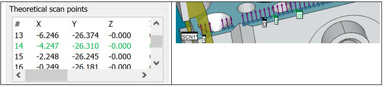

Textual (green text) and Graphical (green sphere) representation view of theoretical scan points. In the Graphic view, a label with scan speed (in green) shows the speed set at that point.
