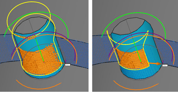

You can enable the CAD offset option for all 3D Auto features and all 3D Constructed Extracted features (Plane, Cone, Cylinder, and Sphere). The CAD offset option provides a way for PC-DMIS to "shrink away" from the selected CAD face boundaries and eliminate points which are within the offset distance to the edges of the feature.
When you select this check box, PC-DMIS creates a yellow offset boundary around each feature in the CAD model on the surface.
Example of a Plane Auto feature with CAD-based clipping enabled
Example of a Cylinder Auto feature with CAD offset of 1 (left) and CAD offset 3 (right)
PC-DMIS draws the boundary around the selected surface to show the area of the considered points. You must select a CAD face when you use the CAD offset option.
PC-DMIS clips the laser data that falls inside of an offset boundary for all of the features in the CAD model on a surface. PC-DMIS uses the data outside of the offset boundary to solve the plane.
