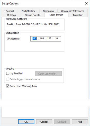

Open the Setup Options dialog box (Edit | Preferences | Setup) and click the Laser Sensor tab to show the options for your camera.
Setup Options dialog box - Laser Sensor tab example for the HP-L-10.10 sensor
Hardware/Software Area
This area displays the current HP-L-10.10 toolkit version.
Initialization Area
You can use the IP address box to define the IP address of the HP-L-10.10 controller.
Logging Area
Logging area - You can use this area to generate text-based log files that contain communication results between PC-DMIS and the laser sensor when the measurement routine executes. The information it sends to the log files includes scans, nominals of calculated features, and so on. Hexagon Technical Support can use these files to resolve issues that involve your laser sensor.
Log Enabled - This check box enables or disables data sent to the log files.
Open Log Folder - This button opens up the folder that contains your log files.
Typically, PC-DMIS stores these files in the "C:\ProgramData\Hexagon\PC-DMIS\2022.1\NCSensorsLogs\" folder.
Delete logged data at startup - This check box deletes the logged data files from the log folder whenever you create a new measurement routine.
Draw Laser Working Area Check Box
If you select the Draw Laser Working Area check box, the HP-L-10.10 probe parameters draw the trapezoid with the correct dimensions. This functionality helps with simulation in Offline mode. This feature is available for laser Auto features and laser scans.

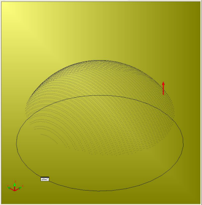

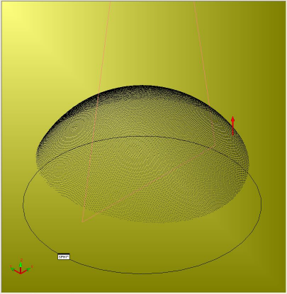

Point Reduction Filter list - This list determines whether or not PC-DMIS filters points along the scan line. You can select the desired percentage of total points to filter. If you select the OFF option, PC-DMIS acquires the complete data set without any filtering.
Example
of Point Reduction Filter Set to OFF
Example
of Point Reduction Filter Set to 50%

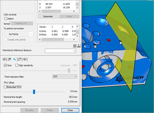

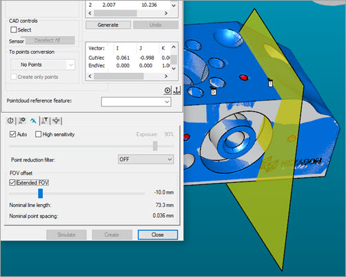

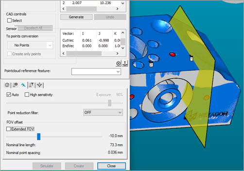

Extended FOV check box and slider - Select the Extended FOV check box to extend your field of view (FOV) measurement range an extra 30 mm. When you enable this option, PC-DMIS triggers a new scaling for the Extended FOV slider. This allows you to adjust the standoff from -30 to 60 mm. As soon as you move the slider to the Extended FOV location, the software highlights the background yellow. This notifies you that you can expect a higher dispersion when the standard FOV is left. If you have laser Live View active with Extended FOV enabled, PC-DMIS adjusts the FOV accordingly.
Example with no Extended FOV
Example with Extended FOV
If you create a scan using the Standard FOV (the Extended FOV check box is not selected) and later edit that scan with the Extended FOV check box selected, the scan path remains the same. All subsequent executions of the scan are done using the Standard FOV.

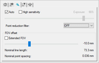

You can use the slider to change the center of the field of view for the scan. Here's an example of the same image above without the Extended FOV selected, but the FOV offset changed from -10.0 mm to 0 (zero):
The Nominal line length and Nominal point spacing values dynamically change based on the position of the FOV slider.
