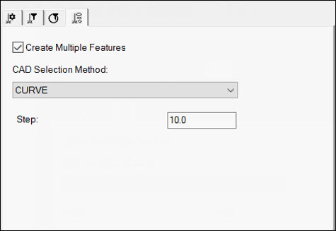

Create Multiple Features - To select curves on the model to create multiple features, select this check box. For Surface Point features, surfaces are selected instead. Note the following:

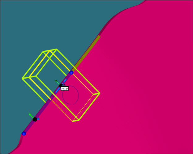

The curves must be contiguous. To select or deselect them, press Ctrl. Consider these examples:
Using Ctrl to select additional contiguous curves

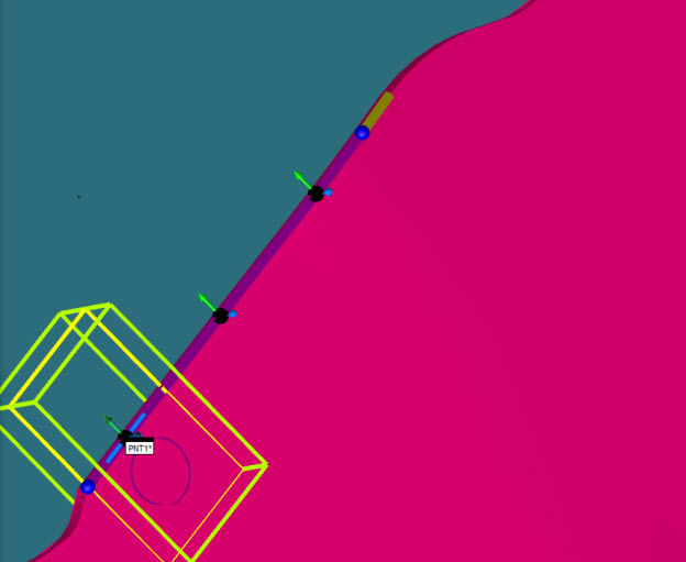

The first point PC-DMIS creates on the curve is at a distance equal to the Horizontal Clipping value plus the Spacer value with respect to the start point of the curve itself. This is done on purpose so that PC-DMIS does not extract the first point off of the desired curve. For example:
First curve selection

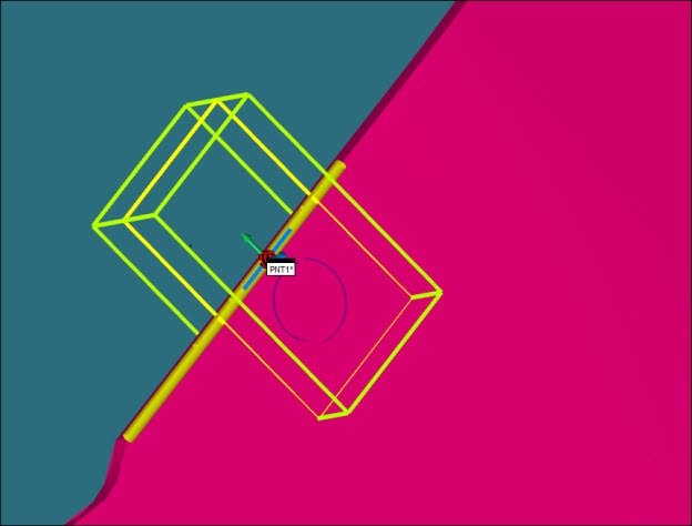

You can use the dragging functionality to select portions of the CAD curves. The features update accordingly.

CAD Selection Method - Select the desired CAD element.
Step - This option enables you to select the spacing along the selected curve or curves between the features you are creating.

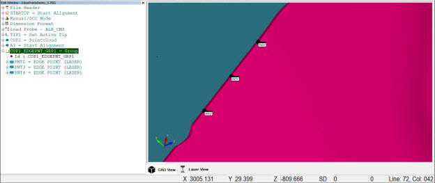

A result of a multiple creation appears below:
