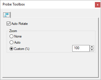

Custom (%) - If you select this option, you can set the zoom percentage. 100% indicates the zoom factor is set using the actual part size (1:1 relationship). You can set the zoom percentage larger to a get a close-up view of the scan, or smaller to see more of the pointcloud at a reduced size. For example, 50% would be half size.
Probe Toolbox - Laser Scan Display Properties tab with Auto Rotate and Custom (%) Zoom options selected
