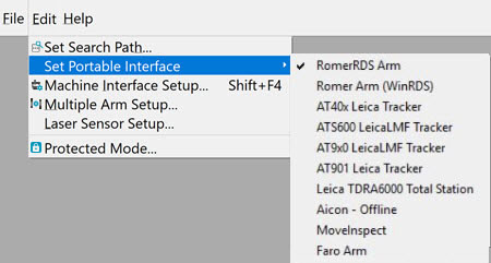

From the opening PC-DMIS screen, click Edit | Set Portable Interface from the menu.
Select the portable interface you want PC-DMIS to run from the list of available interfaces. A check mark identifies the active portable interface.
You can uncheck a selected Portable interface and run PC-DMIS with no portable interface selected. In this case, the software uses the interfac.dll (if it exists) the next time PC-DMIS starts up.
When you select a device from the menu, the software dynamically switches the interface without having to close and then reopen PC-DMIS.

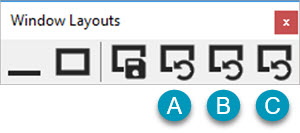

The toolbars specific to the selected interface are available but are not automatically displayed. If you work with multiple portable interfaces, you can define a layout in PC-DMIS for each portable interface type and then save them to the Window Layouts toolbar. This saves you time by not having to redefine your PC-DMIS screen components whenever you change interfaces. For details on how to setup PC-DMIS window layouts, see "Setting Up the Screen View" in the PC-DMIS Core documentation.
A - LeicaLMF
B - RomerRDS Scan
C - Aicon Offline
