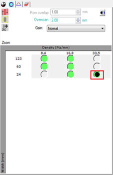

CMS ScanMode set to 2

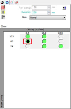

CMS ScanMode set to 3
