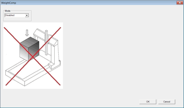

Use the Disabled mode to disable the Weight Compensation. You should place the command for disabling Weight Compensation at the end of the measurement routine in order to avoid undesired persistence of Weight Compensation among different measurement routines.
To use this mode, do the following:
In the Mode list, click Disabled to open the WeightComp dialog box.
WeightComp dialog box - Disabled mode
Click OK.

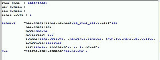

Here is an example of the Edit window for the Disabled mode:
Example of Edit window for Disabled mode
