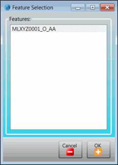

Select feature to get CAD point icon: Copies the feature definition settings from an existing feature. When you click the icon, the Feature Selection dialog box opens to display the ID of each feature in your measurement routine. Here is an example of the dialog box for the AA feature for the Point measuring principle:
Select the ID with the settings that you want to copy, and then click the OK button. To close the dialog box without copying any settings, click the Cancel button. If your measurement routine does not contain any features, a message appears and indicates that no features exist in the measurement routine. For more information about feature definition settings and the feature ID, refer to the appropriate help topic: |
