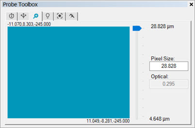

The Magnification tab lets you change the current Field of View (FOV) camera magnification. It also provides a way for you to simultaneously view both the CAD and Vision tabs of the Graphic Display window. For information on using these tabs in the Graphic Display window, see "Using the Graphic Display window in PC-DMIS Vision".
Two values for magnification are displayed - Pixel Size and Optical.
Pixel Size - This is the pixel size of the image in the Live View.
Optical - This is the magnification size on the CCD array of the camera. This does not change when the Live View display is re-sized.
